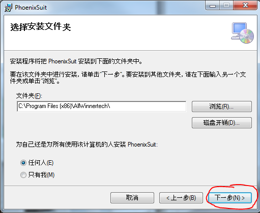

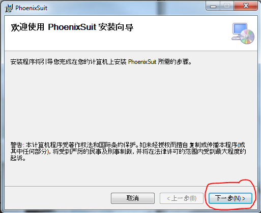

Hi,
is there anyway to install phoenixsuite on my Win7 – 64 bit PC ?
Tried hundred and one times, just wont have it, my v972 is just a piece of plastic without it.
Thanks
Steve.
2013/03/06
16:10
EffKay
Forum Posts: 11
Thanks Received: 4
2013/02/26
No Archos/Arnova device
64

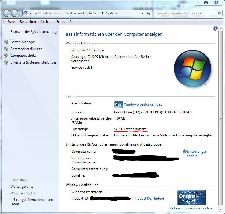

@merc69, at what point do you fail? I've Phoenixsuite installed on two Win7 64Bit PCs with no hassle at all and flashed my V972 from both of them.
2013/03/06
16:42
merc69
Forum Posts: 7
Thanks Received: 2
2013/03/05
65
Hi, i try to instal normally, and as administrator… i get s far as--instal pjhoenix, click y then the instal screen pops up,  the screen shows —  instal or cancel ( in chinese ) but the instal is greyed out? just the cancel is operational :0(
im using vs 1.06 phoenix instaler
cheers
steve.

66
When I start the installer, it asks me for Admin-rights and comes up with:
This is my Win… it's german but you can see, its 64Bit.

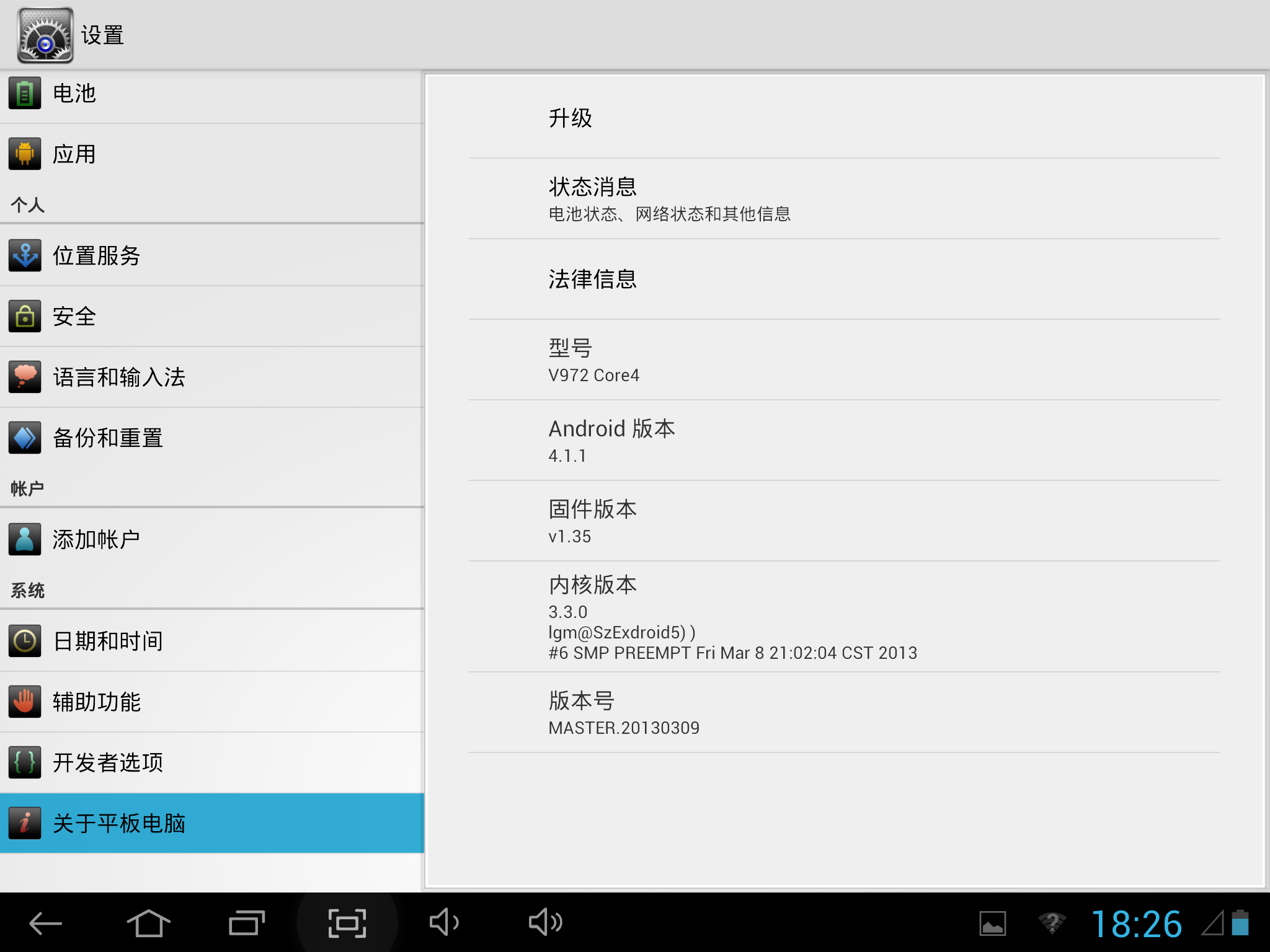

Firmware 1.35 seems Faster, shame its ALL IN CHINESE  [[** please register to see this link **]]
