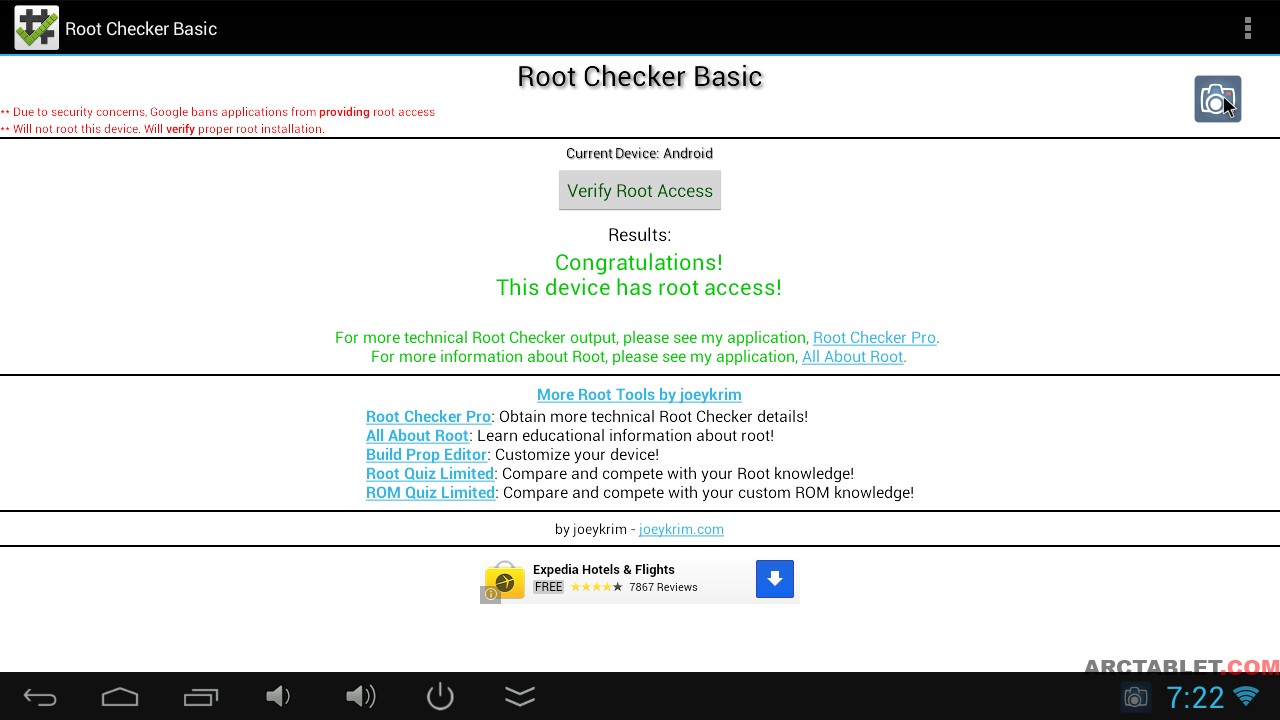

- root with latest SuperSU 1.04 (free version)

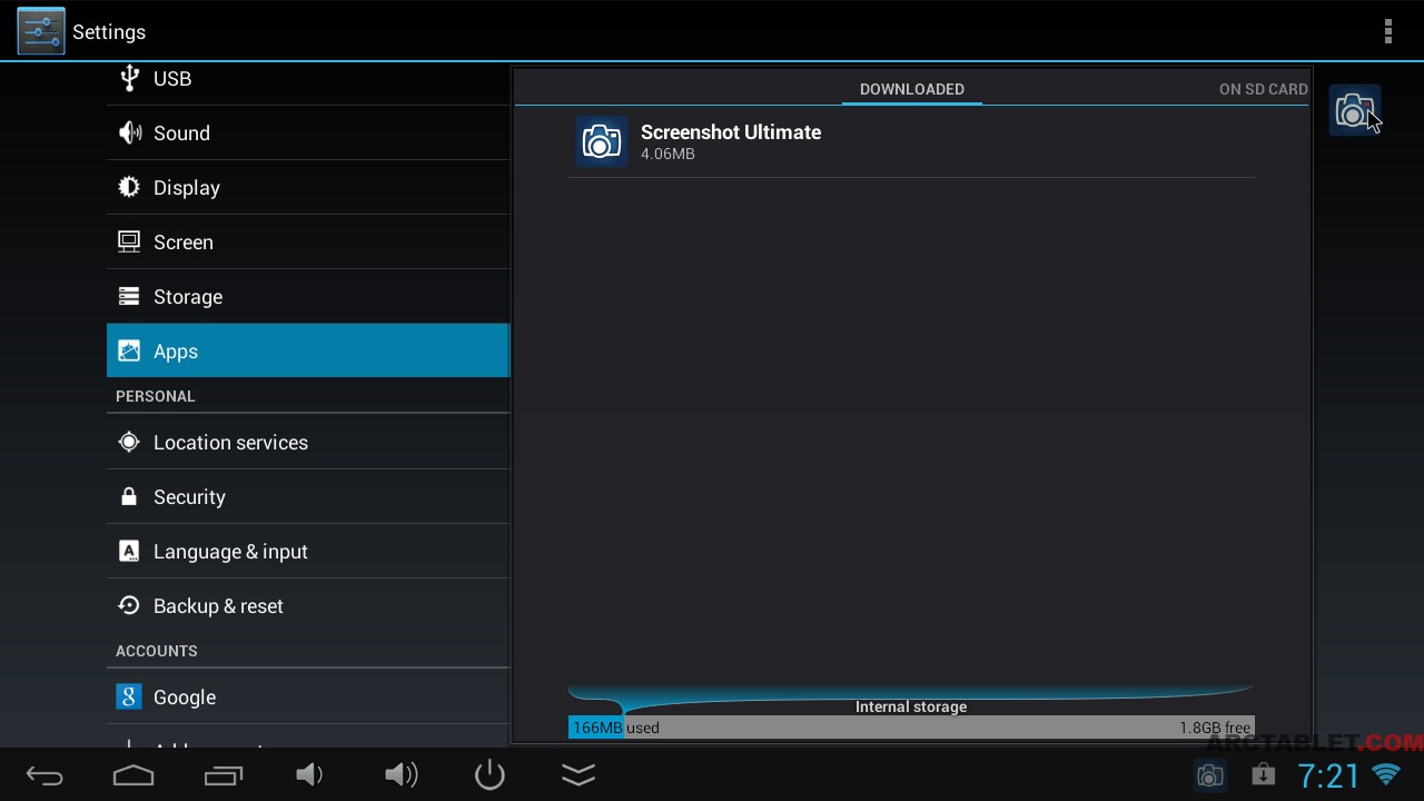

- increased space for application (/data partition) to 2 Gb.
