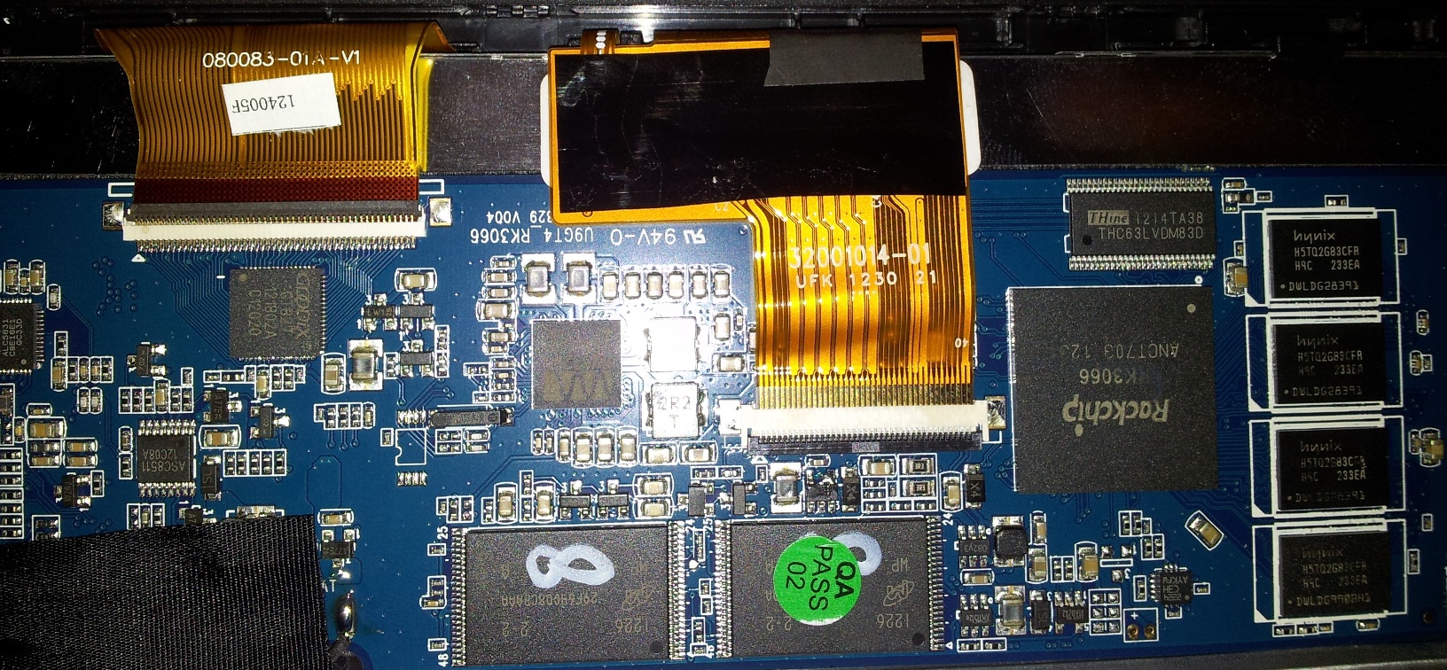

please the mb is this: what are the pins to contacts?

U9GT4 on foto.

but on the back cover and in the system info the tablet is u23gt, maybe have the same mb…
someone know wich are the pin for unbrick???
Unbrick 29th and 30th pin on 29f64g08cbaaa chip that which is nearest to CPU(with green label on your photo)

Thanks, you are the best! Please,What should I do exactly with these pins? Pressure?
Sorry help me please

You should make contact between the 2 pins.
I made a video of the process on another device (MiniPC) also based on RK3066 processor:

 Only not open so the cube how to videos! use the plastic card and start with the connectors, if after a creaking, it eliminates heat latch in a desired angle.

I totally agree with ol213, I posted the video mainly to visualize how it works with Rockchip batch tool (blue square, etc…)
Serious care should be made when opening the tablet with the right tools.

sorry, but i am not an expert, can you draw me a sign on my picture? i don't know wich are the pins.. :-( Cry

ants88 said
hello guys, I brick my tablet, cube u23gt, during the flash appear IDB Download Fail…I'm desperate, i now for the u30gt it's easy to unbrick the tablet, is sufficient to connect two contacts, but these are different of my u23gt…I disassembled it, but I do not know what to do, what are the contacts you want to merge for the maskrom mode??? please help me..
Ants, there is no need to open the tablet : Rockchip tablets are unbrickable, as the chipset embeds a bootloader on ROM (non-writable memory). Just unplug the charger, turn off your tablet, then press "vol+" and "power" together for 10s to switch to download mode.
See this thread : [[** please register to see this link **]] (U9GT3 and U23GT share the same hardware)

thanks very much, i will try it in the afternoon, you give me hope..
