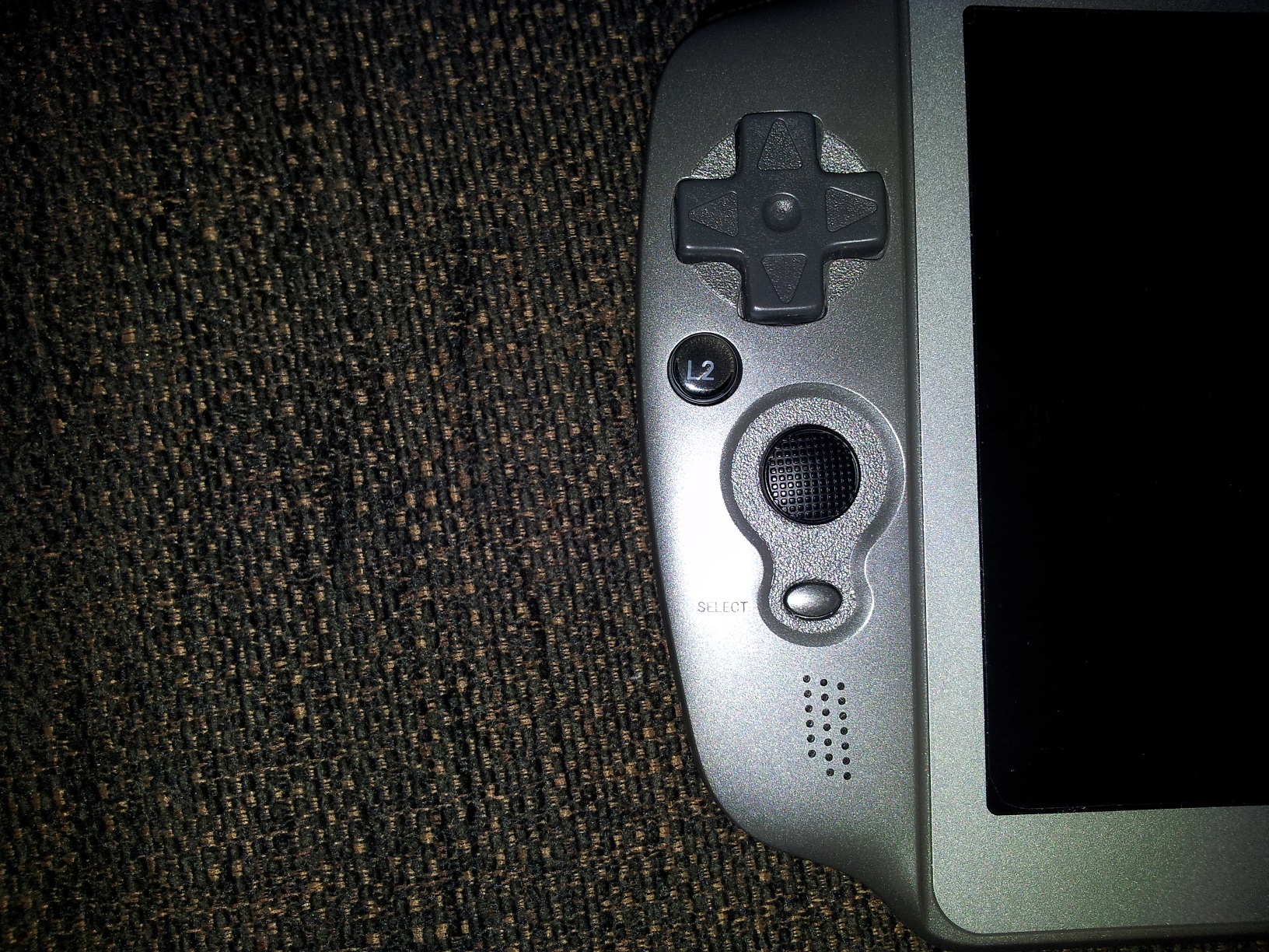

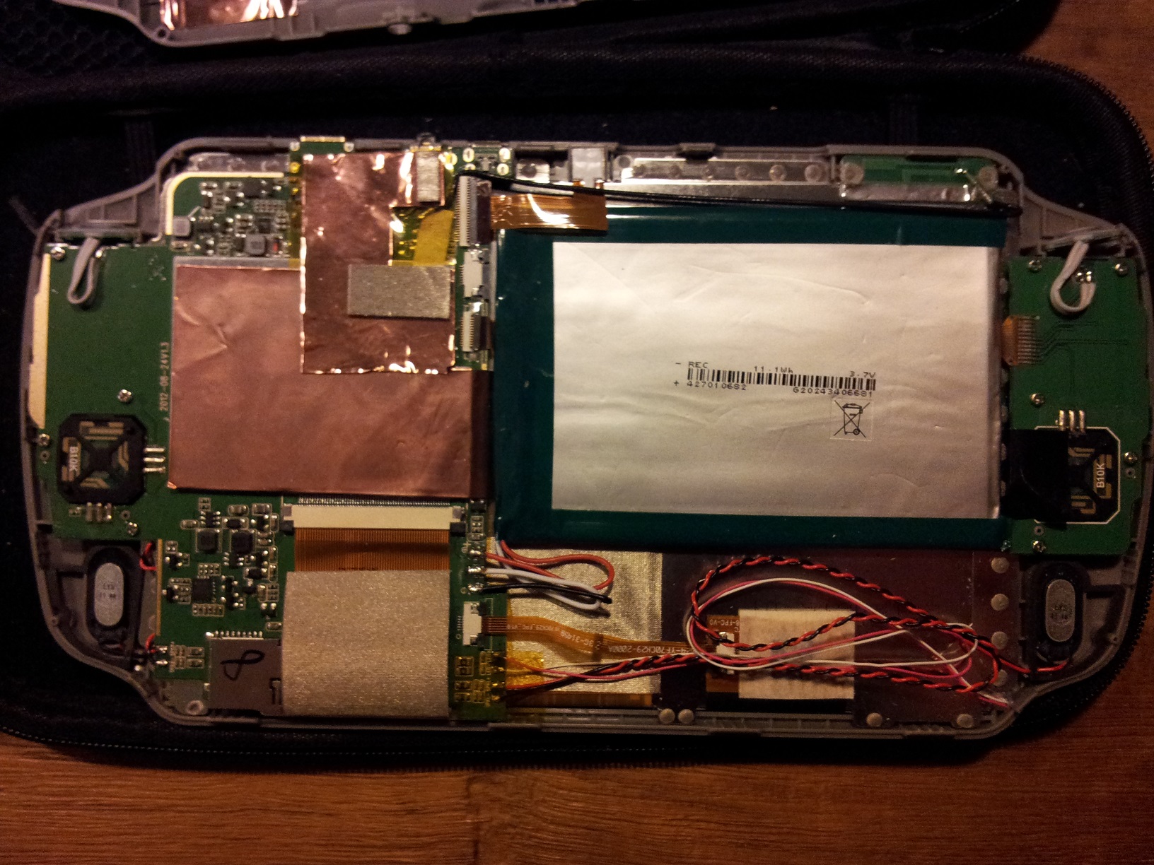

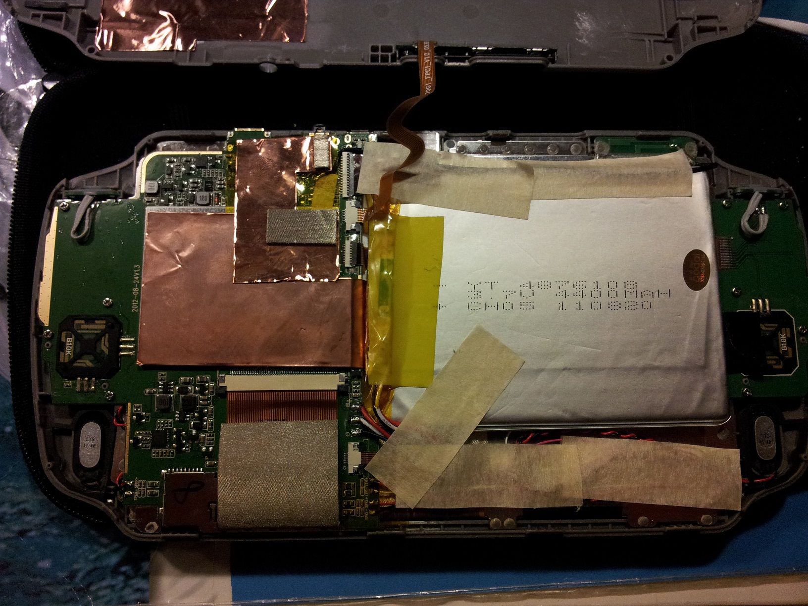

Finally managed to mod my Gamepad with a new battery, didn't buy a battery from [[** please register to see this link **]] because the delivery cost are too much, I could not find a battery here in the netherlands or europe for a nice price so I went for this one:
Although It's from china and not recommended by Hailraizer but It could not be worse than the stock battery from archos.
It took 4 weeks to receive it but I got it. It fit's perfect with some modifying of the corners of the battery.
Now I will see how long it will last.
Also bought this one: http://www.aliexpress.com/snapshot/216822243.html
and it is a little smaller and would fit somewhat better I think but this one is 4000 Mah and the other is 4400 Mah so I when't for that one.
The gamepad is somewhat heavier but I like it better feels more natural for a tablet.
Hailrazer I followed the tutorial and worked perfect thanks a lot now I'm a lucky owner of a Gamepad with a better battery and also a new d-pad (from a snes controller, took some time to get it perfect but now all is great)
before:
After:
The D-pad:
